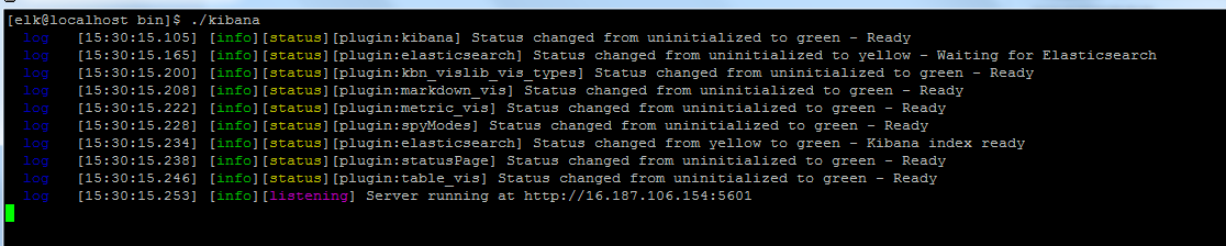

[*]kibana正常启动

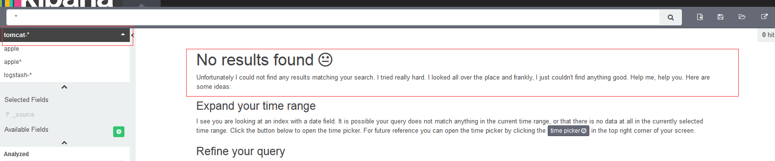

[*]kibana中创建名为tomcat-*的索引后查询无数据

junjielee - Pythonor in Guangzhou
默认的时间比较短,修改下查看今天的?
或者你可以用 elasticsearch的 rest api查看数据,如果有数据,但是kibana对应日期的没有显示,可能就是配置问题了

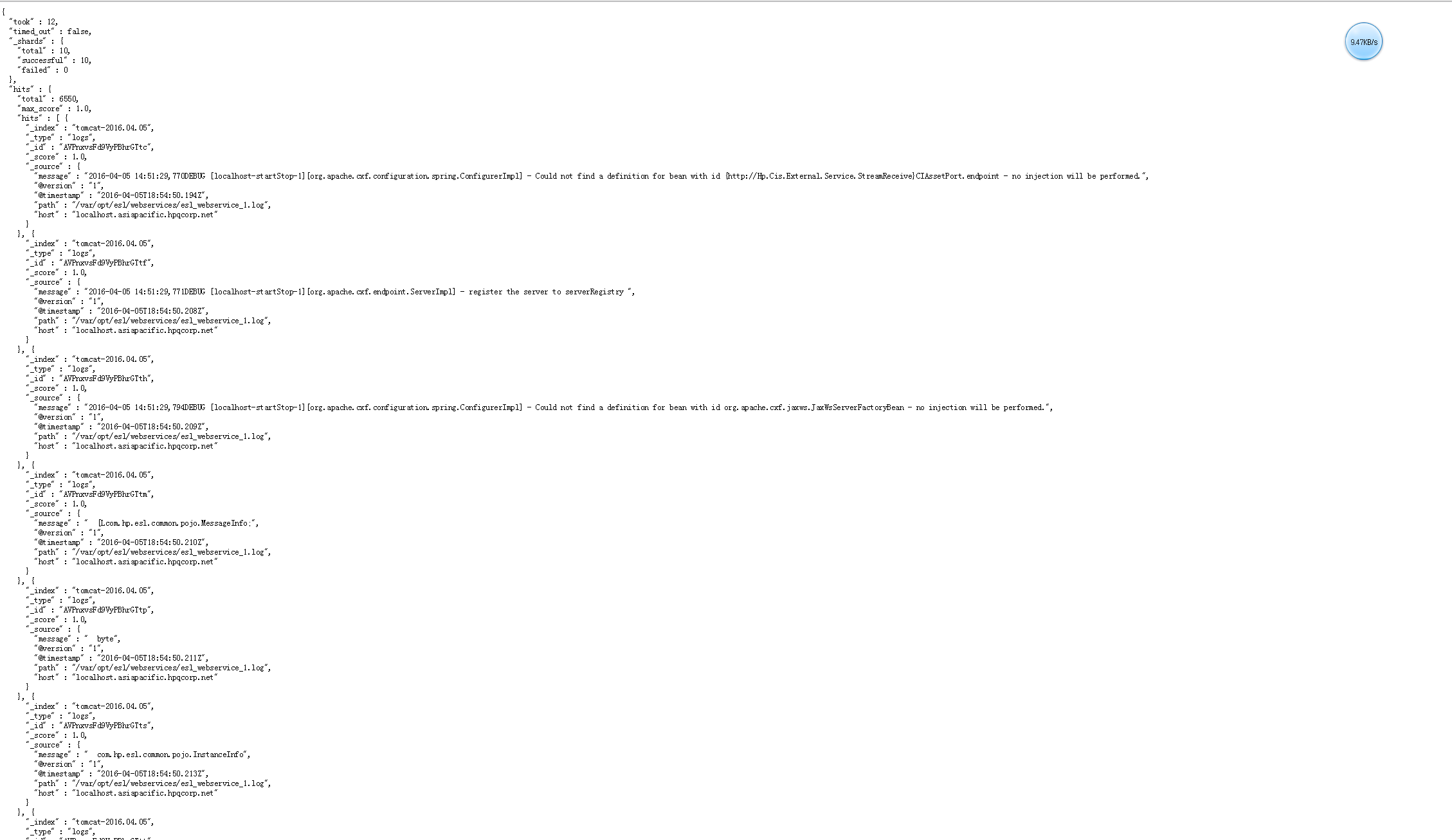

@junjielee,谢谢你的回复,我去google了下es的查询相关的只是,用了这个方式得到了如下结果,我看这结果感觉很奇怪,是我的日志格式不满足es的格式要求吗,求指教.
  • 使用*/logs/_searchpretty=true[/url]地址获取如下信息
  • { "took" : 33, "timed_out" : false, "_shards" : { "total" : 10, "successful" : 10, "failed" : 0 }, "hits" : { "total" : 5697, "max_score" : 1.0, "hits" : [ { "_index" : "tomcat-2016.04.05", "_type" : "logs", "_id" : "AVPnxvsFd9VyPBhrGTtc", "_score" : 1.0, "_source" : { "message" : "2016-04-05 14:51:29,770DEBUG [localhost-startStop-1][org.apache.cxf.configuration.spring.ConfigurerImpl] - Could not find a definition for bean with id {http://Hp.Cis.External.Service.StreamReceive}CIAssetPort.endpoint - no injection will be performed.", "@version" : "1", "@timestamp" : "2016-04-05T18:54:50.194Z", "path" : "/var/opt/esl/webservices/esl_webservice_1.log", "host" : "localhost.asiapacific.hpqcorp.net" } }, { "_index" : "tomcat-2016.04.05", "_type" : "logs", "_id" : "AVPnxvsFd9VyPBhrGTtf", "_score" : 1.0, "_source" : { "message" : "2016-04-05 14:51:29,771DEBUG [localhost-startStop-1][org.apache.cxf.endpoint.ServerImpl] - register the server to serverRegistry ", "@version" : "1", "@timestamp" : "2016-04-05T18:54:50.208Z", "path" : "/var/opt/esl/webservices/esl_webservice_1.log", "host" : "localhost.asiapacific.hpqcorp.net" } }, { "_index" : "tomcat-2016.04.05", "_type" : "logs", "_id" : "AVPnxvsFd9VyPBhrGTth", "_score" : 1.0, "_source" : { "message" : "2016-04-05 14:51:29,794DEBUG [localhost-startStop-1][org.apache.cxf.configuration.spring.ConfigurerImpl] - Could not find a definition for bean with id org.apache.cxf.jaxws.JaxWsServerFactoryBean - no injection will be performed.", "@version" : "1", "@timestamp" : "2016-04-05T18:54:50.209Z", "path" : "/var/opt/esl/webservices/esl_webservice_1.log", "host" : "localhost.asiapacific.hpqcorp.net" } }, { "_index" : "tomcat-2016.04.05", "_type" : "logs", "_id" : "AVPnxvsFd9VyPBhrGTtm", "_score" : 1.0, "_source" : { "message" : " [Lcom.hp.esl.common.pojo.MessageInfo;", "@version" : "1", "@timestamp" : "2016-04-05T18:54:50.210Z", "path" : "/var/opt/esl/webservices/esl_webservice_1.log", "host" : "localhost.asiapacific.hpqcorp.net" } }, { "_index" : "tomcat-2016.04.05", "_type" : "logs", "_id" : "AVPnxvsFd9VyPBhrGTtp", "_score" : 1.0, "_source" : { "message" : " byte", "@version" : "1", "@timestamp" : "2016-04-05T18:54:50.211Z", "path" : "/var/opt/esl/webservices/esl_webservice_1.log", "host" : "localhost.asiapacific.hpqcorp.net" } }, { "_index" : "tomcat-2016.04.05", "_type" : "logs", "_id" : "AVPnxvsFd9VyPBhrGTts", "_score" : 1.0, "_source" : { "message" : " com.hp.esl.common.pojo.InstanceInfo", "@version" : "1", "@timestamp" : "2016-04-05T18:54:50.213Z", "path" : "/var/opt/esl/webservices/esl_webservice_1.log", "host" : "localhost.asiapacific.hpqcorp.net" } }, { "_index" : "tomcat-2016.04.05", "_type" : "logs", "_id" : "AVPnxvsFd9VyPBhrGTtt", "_score" : 1.0, "_source" : { "message" : " com.hp.esl.common.pojo.MessageInfo", "@version" : "1", "@timestamp" : "2016-04-05T18:54:50.213Z", "path" : "/var/opt/esl/webservices/esl_webservice_1.log", "host" : "localhost.asiapacific.hpqcorp.net" } }, { "_index" : "tomcat-2016.04.05", "_type" : "logs", "_id" : "AVPnxvsFd9VyPBhrGTtx", "_score" : 1.0, "_source" : { "message" : " com.sun.xml.bind.api.CompositeStructure", "@version" : "1", "@timestamp" : "2016-04-05T18:54:50.232Z", "path" : "/var/opt/esl/webservices/esl_webservice_1.log", "host" : "localhost.asiapacific.hpqcorp.net" } }, { "_index" : "tomcat-2016.04.05", "_type" : "logs", "_id" : "AVPnxvsFd9VyPBhrGTt6", "_score" : 1.0, "_source" : { "message" : " java.lang.Class", "@version" : "1", "@timestamp" : "2016-04-05T18:54:50.236Z", "path" : "/var/opt/esl/webservices/esl_webservice_1.log", "host" : "localhost.asiapacific.hpqcorp.net" } }, { "_index" : "tomcat-2016.04.05", "_type" : "logs", "_id" : "AVPnxvsFd9VyPBhrGTt_", "_score" : 1.0, "_source" : { "message" : " java.lang.Object", "@version" : "1", "@timestamp" : "2016-04-05T18:54:50.237Z", "path" : "/var/opt/esl/webservices/esl_webservice_1.log", "host" : "localhost.asiapacific.hpqcorp.net" } } ] } }

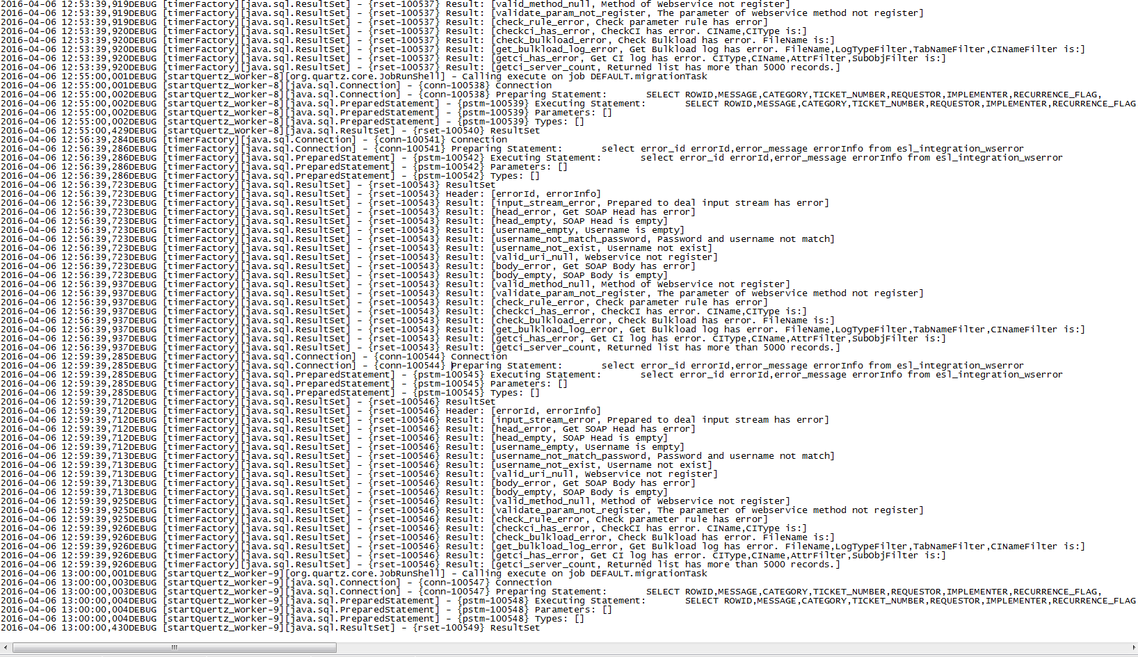

  • tomcat日志内容,一小段[list][*]
[/list]
guoyiqin
直接*查询是查不出来的 你试试*:*
coolloves - search...
kibana取值好像都要时间戳,你先看看索引里面有数据吗?
curl localhost:9200/indexname/_search?size=10&from=0&pretty
yunlong_yuan
感谢楼上两位的回答,我尝试用*:*还是没有效果。尝试查询索引有数据,截图如下
