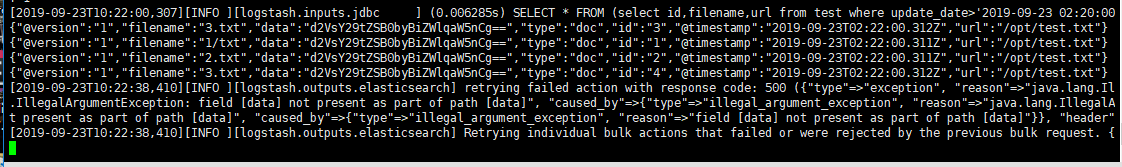

[2019-09-23T10:32:00,375][INFO ][logstash.inputs.jdbc     ] (0.008332s) SELECT * FROM (select id,filename,url from test where update_date>'2019-09-23 02:30:00') AS `t1` LIMIT 50000 OFFSET 0
{"@version":"1","filename":"1/txt","data":"d2VsY29tZSB0byBiZWlqaW5nCg==","type":"doc","id":"1","@timestamp":"2019-09-23T02:32:00.376Z","url":"/opt/test.txt"}
{"@version":"1","filename":"3.txt","data":"d2VsY29tZSB0byBiZWlqaW5nCg==","type":"doc","id":"3","@timestamp":"2019-09-23T02:32:00.376Z","url":"/opt/test.txt"}
{"@version":"1","filename":"2.txt","data":"d2VsY29tZSB0byBiZWlqaW5nCg==","type":"doc","id":"2","@timestamp":"2019-09-23T02:32:00.376Z","url":"/opt/test.txt"}
{"@version":"1","filename":"3.txt","data":"d2VsY29tZSB0byBiZWlqaW5nCg==","type":"doc","id":"4","@timestamp":"2019-09-23T02:32:00.376Z","url":"/opt/test.txt"}
[2019-09-23T10:32:14,502][INFO ][logstash.outputs.elasticsearch] retrying failed action with response code: 500 ({"type"=>"exception", "reason"=>"java.lang.IllegalArgumentException: java.lang.IllegalArgumentException: field [data] not present as part of path [data]", "caused_by"=>{"type"=>"illegal_argument_exception", "reason"=>"java.lang.IllegalArgumentException: field [data] not present as part of path [data]", "caused_by"=>{"type"=>"illegal_argument_exception", "reason"=>"field [data] not present as part of path [data]"}}, "header"=>{"processor_type"=>"remove"}})
[2019-09-23T10:32:14,503][INFO ][logstash.outputs.elasticsearch] Retrying individual bulk actions that failed or were rejected by the previous bulk request. {:count=>1}

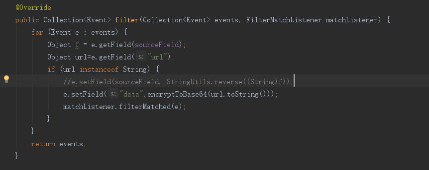

从mysql 读取数据库数据,在logstash 的filter 里根据数据的路径url ,读取文件内容转成base64,输出到elasticsearch:

filter {
    java_filter_encode{
        source => "message"
output {

附件是异常信息和filter的截图

数据已经存进es里了,就是报了这个异常,各位大佬,帮我看下这个异常是什么意思
