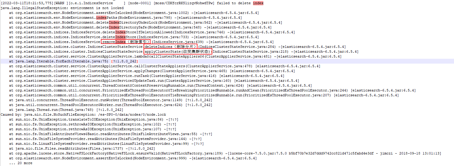

看这个日志好像是集群状态改了,然后删分片,然后又删索引,有人能帮忙分析下是什么导致的吗

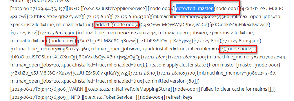

hihins
这个是新增加那个节点的es日志
[2023-06-27T09:44:22,837][INFO ][o.e.e.NodeEnvironment    ] [node-0004] using [1] data paths, mounts [[/es-SP0-0 (/dev/sdf)]], net usable_space [1.7tb], net total_space [1.7tb], types [xfs]

[2023-06-27T09:44:35,857][INFO ][o.e.c.s.ClusterApplierService] [node-0004] detected_master {node-0001}{4ZxhZb_eSJ-M8C8C-4Xuzw}{c2JthES1StOv-qrKaYyjwg}{172.125.6.10}{172.125.6.10:9300}{ml.machine_memory=99802255360, ml.max_open_jobs=20, xpack.installed=true, ml.enabled=true}, added {{node-0003}{G9SOEwCMQWW5DPbG5iVJGg}{jFKGdhkiSOuFhkaxPaZwcg}{172.125.6.12}{172.125.6.12:9300}{ml.machine_memory=201270022144, ml.max_open_jobs=20, xpack.installed=true, ml.enabled=true},{node-0001}{4ZxhZb_eSJ-M8C8C-4Xuzw}{c2JthES1StOv-qrKaYyjwg}{172.125.6.10}{172.125.6.10:9300}{ml.machine_memory=99802255360, ml.max_open_jobs=20, xpack.installed=true, ml.enabled=true},{node-0002}{bKoOipxJSFOSL1msXcOXmQ}{jRGxVxUsQyaXBmxjwg7OgQ}{172.125.6.11}{172.125.6.11:9300}{ml.machine_memory=201270022144, ml.max_open_jobs=20, xpack.installed=true, ml.enabled=true},}, reason: apply cluster state (from master [master {node-0001}{4ZxhZb_eSJ-M8C8C-4Xuzw}{c2JthES1StOv-qrKaYyjwg}{172.125.6.10}{172.125.6.10:9300}{ml.machine_memory=99802255360, ml.max_open_jobs=20, xpack.installed=true, ml.enabled=true} committed version [80]])

[2023-06-27T09:46:09,740][WARN ][o.e.i.IndicesService     ] [node-0004] [moss/XiT1RtZ5SZWRKRmLTHIZTg] failed to delete index
org.elasticsearch.env.ShardLockObtainFailedException: [moss][1]: obtaining shard lock timed out after 0ms
at org.elasticsearch.env.NodeEnvironment$InternalShardLock.acquire(NodeEnvironment.java:730) ~[elasticsearch-6.5.4.jar:6.5.4]
at org.elasticsearch.env.NodeEnvironment.shardLock(NodeEnvironment.java:649) ~[elasticsearch-6.5.4.jar:6.5.4]
at org.elasticsearch.env.NodeEnvironment.lockAllForIndex(NodeEnvironment.java:595) ~[elasticsearch-6.5.4.jar:6.5.4]
at org.elasticsearch.env.NodeEnvironment.deleteIndexDirectorySafe(NodeEnvironment.java:546) ~[elasticsearch-6.5.4.jar:6.5.4]
at org.elasticsearch.indices.IndicesService.deleteIndexStoreIfDeletionAllowed(IndicesService.java:746) ~[elasticsearch-6.5.4.jar:6.5.4]
at org.elasticsearch.indices.IndicesService.deleteIndexStore(IndicesService.java:733) ~[elasticsearch-6.5.4.jar:6.5.4]
at org.elasticsearch.indices.IndicesService.removeIndex(IndicesService.java:639) ~[elasticsearch-6.5.4.jar:6.5.4]
at org.elasticsearch.indices.cluster.IndicesClusterStateService.deleteIndices(IndicesClusterStateService.java:284) ~[elasticsearch-6.5.4.jar:6.5.4]
at org.elasticsearch.indices.cluster.IndicesClusterStateService.applyClusterState(IndicesClusterStateService.java:218) ~[elasticsearch-6.5.4.jar:6.5.4]
at org.elasticsearch.cluster.service.ClusterApplierService.lambda$callClusterStateAppliers$6(ClusterApplierService.java:481) ~[elasticsearch-6.5.4.jar:6.5.4]
at java.lang.Iterable.forEach(Iterable.java:75) [?:1.8.0_242]
at org.elasticsearch.cluster.service.ClusterApplierService.callClusterStateAppliers(ClusterApplierService.java:478) [elasticsearch-6.5.4.jar:6.5.4]
at org.elasticsearch.cluster.service.ClusterApplierService.applyChanges(ClusterApplierService.java:465) [elasticsearch-6.5.4.jar:6.5.4]
at org.elasticsearch.cluster.service.ClusterApplierService.runTask(ClusterApplierService.java:416) [elasticsearch-6.5.4.jar:6.5.4]
at org.elasticsearch.cluster.service.ClusterApplierService$UpdateTask.run(ClusterApplierService.java:160) [elasticsearch-6.5.4.jar:6.5.4]
at org.elasticsearch.common.util.concurrent.ThreadContext$ContextPreservingRunnable.run(ThreadContext.java:624) [elasticsearch-6.5.4.jar:6.5.4]
at org.elasticsearch.common.util.concurrent.PrioritizedEsThreadPoolExecutor$TieBreakingPrioritizedRunnable.runAndClean(PrioritizedEsThreadPoolExecutor.java:244) [elasticsearch-6.5.4.jar:6.5.4]
at org.elasticsearch.common.util.concurrent.PrioritizedEsThreadPoolExecutor$TieBreakingPrioritizedRunnable.run(PrioritizedEsThreadPoolExecutor.java:207) [elasticsearch-6.5.4.jar:6.5.4]
at java.util.concurrent.ThreadPoolExecutor.runWorker(ThreadPoolExecutor.java:1149) [?:1.8.0_242]
at java.util.concurrent.ThreadPoolExecutor$Worker.run(ThreadPoolExecutor.java:624) [?:1.8.0_242]
at java.lang.Thread.run(Thread.java:748) [?:1.8.0_242]

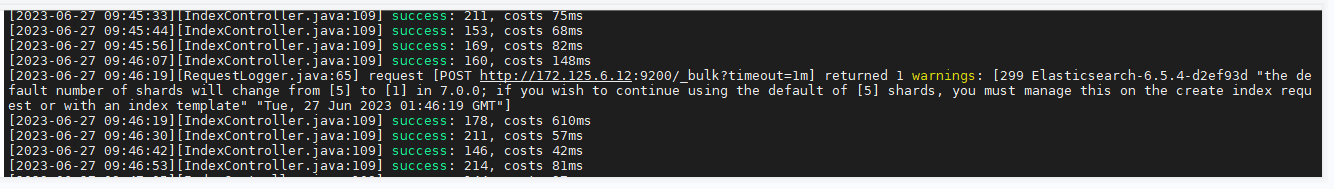

hihins
写入es脚本的上一秒和下一秒都在写数据,中间突然报了个索引没了,以默认5分片创建了。
